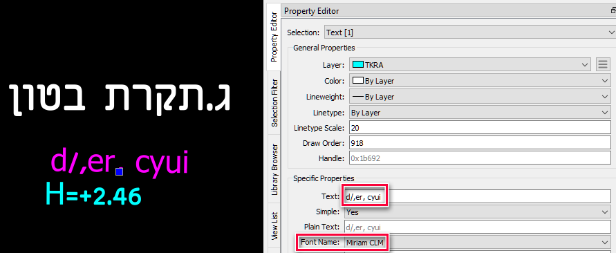

I think I'm not being clear: I have Miriam CLM fonts installed already system wide. Additionally, I have Miriam CLM fonts installed in the QCAD 'fonts' folder:
Miriam CLM is designated as substitute font as well:
Still text is in meaningless Latin characters (notice how MIriam CLM is the designated font):
What am I not doing right?

I tried manually changing the font - all that does is change the font, not the encoding (which is the issue). Latin characters remain.
It found 4 fonts because there are 4 fonts that the draftsman used: HEBTXT, MYRIL, mirym, heb. All of these are .shx. Text is shown in 'properties' in Latin characters but is encoded into Hebrew on the sheet itself.
All I'm wondering if there's a magical way QCAD can read .shx fonts, because at this point it seems it can't even detect they exist.

I actually manually changed the text you selected to unicode so that the characters would be natively Hebrew. That's why you see it that way. It's time consuming but doable for small sheets. It becomes a problem for large sheets as it then becomes outright cisyphic work.

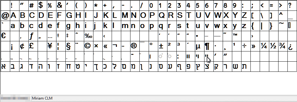

Then that was the wrong turn, here one should have provided {HEBTEXT, MIRYL, mirym, heb} in TTF format.
Most TTF fonts that support Hebrew glyphs have indeed the standard Latin characters up to 128,
where a compiled shape or font file (SHX) might associate Hebrew glyphs with those ASCII addresses.
