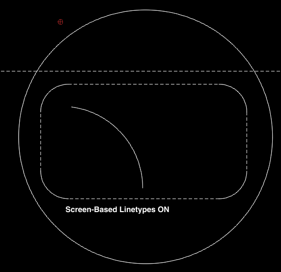

Going to hijack this topic for a moment ... :shock:
bambuko wrote:
Wed Sep 01, 2021 10:18 am
I am using dashed line, Dashed (.5x) to be precise, scaled at 0.1 to draw some lines and circles.
Lines display OK, but circles appear solid and not dashed :?
I am confused...
Yep, that annoys me for some time too ...
All entities are on the same layer, Dashed .5, 0.35, no scale, Screen-Based Line-types mode "ON", unfortunately (confusingly!) correct rendering fails for arcs and circles.
dashed.dxf
(102.77 KiB) Downloaded 835 times
... back to bambuko! :lol:

Thu Sep 02, 2021 10:38 pm
Same here: :wink:
A: Not using Screen Based the Linetype Scale has to be adequate in relation with the drawing size.
B: Solved for splines entities a while ago.
C: The dashes reappear at a certain deeper zoom state.
D: For some entities dashes may reappear with a higher minimum rendering angle step value.
(App.Prefs. Appearance; Default is 0.2).

Posts: 4995
Re: dashed linetype (circles ve lines)
Post by CVH » Fri Sep 03, 2021 8:46 am
bambuko wrote:
Fri Sep 03, 2021 8:17 am
I have tried zooming in - made no difference
With Husky's file. ScreenBased.
At this zoom state the larger circle looks dashed.
The polyline arc right-low not yet.
There the dashes will reappear when zooming in to about 2x2 units.
For the 1/4 arc in the middle of the drawing dashes will reappear somewhat in between those zoom states.
So it seems radius related ... :?
