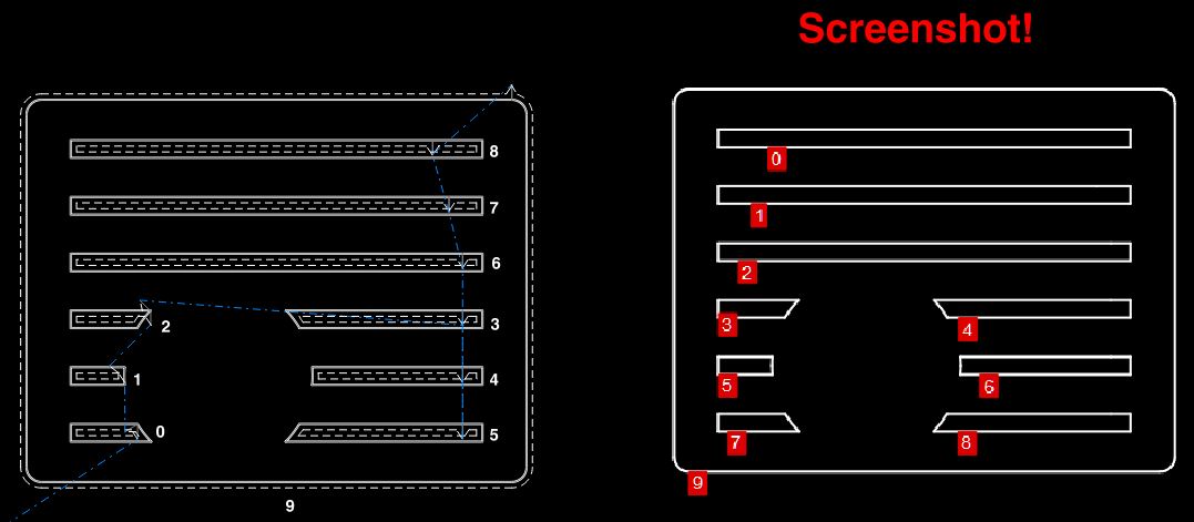

I need to follow a chronological order in a milling process. In a test drawing I reordered the entities, created a path and was surprised that my order wasn't used by QCADCAM. How can I tell QCAD/CAM to follow "my" chronological order?
On the right side a screenshots shows my "wish" order and on the left side the created order from the Toolpath tool.

The contours in a single toolpath are ordered automatically for shortest path. If you need to be in control of the exact order, you need to create an individual toolpath for each contour.

Next idea: In my case I can use the same tool for every path. I hoped that I'm able to "trick" QCAD for this task with a different approach, selected the contours one by one in the order I need, launched "Add Profile Toolpath" to created the Toolpath for all contours all together what would shorten the user input in around the half. Well, QCAD noticed it is a single toolpath, took over and created again the "shortest" Toolpath.
I assume that is a great achievement in the eye of a programmer but the problem is I can't control this "Artificial Intelligence" - I need to use "Natural intelligence" in this case.

Ok, as you know it is debatable what is the shortest or best path and in my case the created optimum isn't usable. However - I also learned that I haven't understood the QCAD/CAM Reference Manual explanation for "Reorder": Quote - ... for certain types of further processing (such as CAM), the order of entities can be crucial. End Quote. Well - I thought with Reorder I can control the order for all paths but my reordered entities are always overwritten by QCAD
