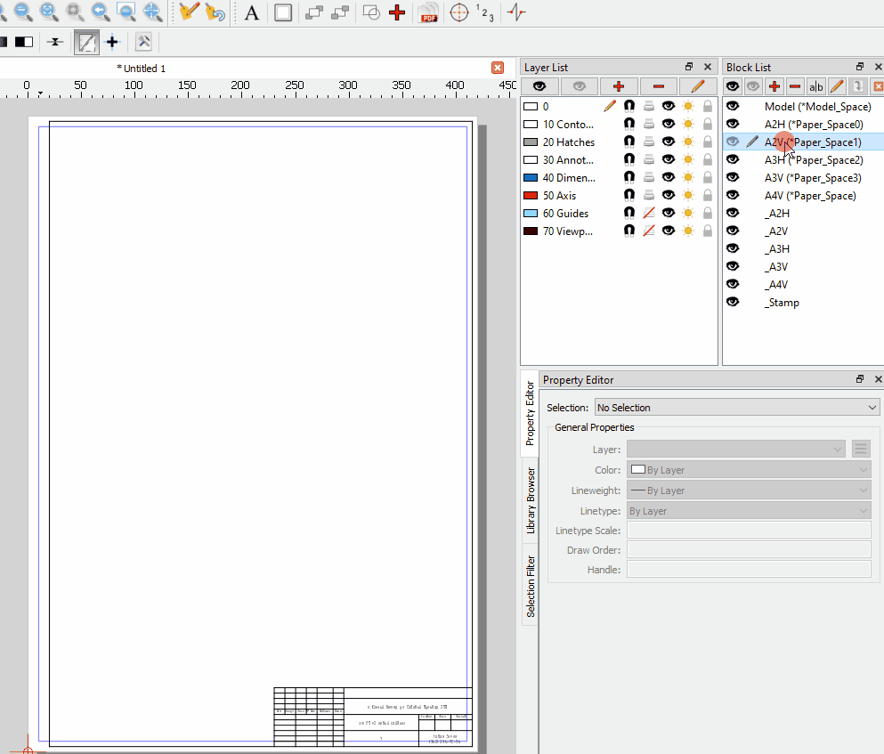

To duplicate the layout block, right-click on the desired layout block and select Duplicate Layout Block from the context menu
dmitpon
- Posts: 21
- Joined: Sun Mar 14, 2021 10:15 am
Post
by dmitpon » Sat Jan 15, 2022 5:16 am
- duplicate-layout-block.gif (88.45 KiB) Viewed 23729 times

dmitpon wrote: ↑Sat Jan 15, 2022 4:58 am
Looks good so far. Thank you!
Question: I noticed that the entities in a copied layout block use the same Draw Order numbers like the source. Does that doesn't causes any trouble?
