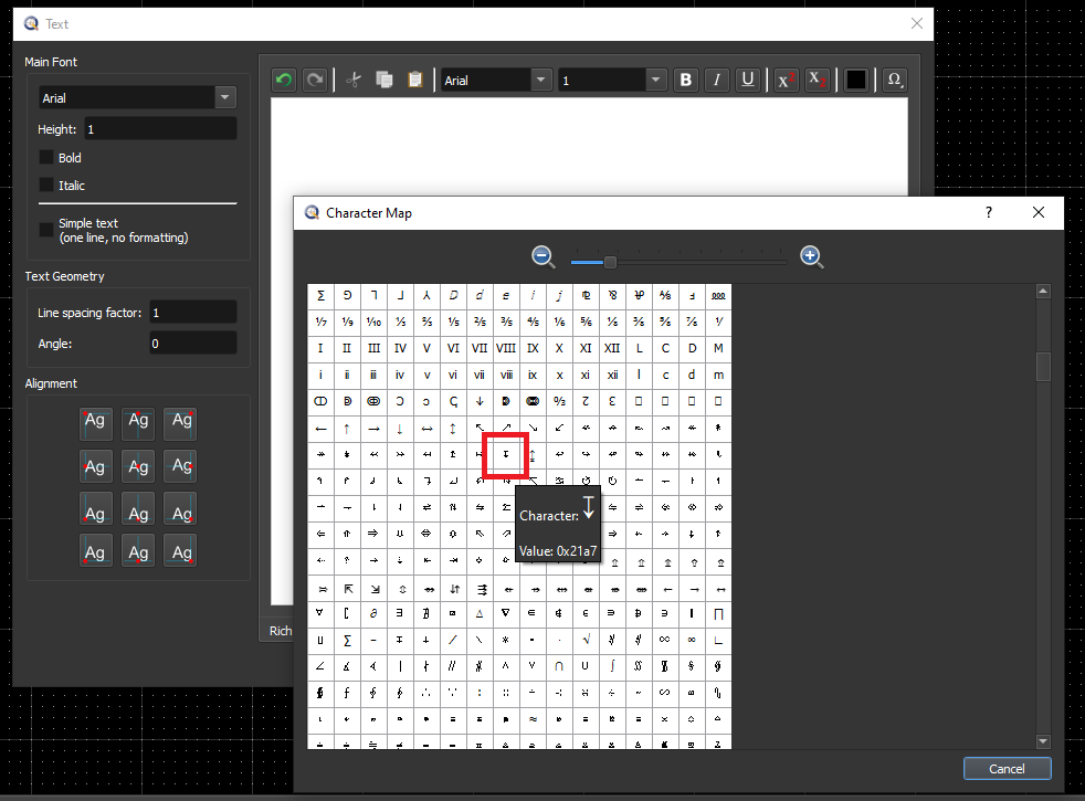

Hi, I'm trying to insert a "depth of plunge" symbol into a text block on Win10/QCAD 3.27.6.
According to https://unicode-table.com/en/21A7/, the symbol I'm looking for is U+21A7 or thereabouts. So I found it in text properties - special characters - others, but this only displays as a "?" symbol. I've tried changing the text font several times, including Unicode, to no avail. Is there an alternative or work-around for this symbol in QCAD?
I am able to use U+2193 (a downwards-pointing arrow) but it would be nice to use the actual symbol. Thanks!

What fonts have you tried? If you use the "standard" font that is the default built-in CXF font that comes with QCAD, it seems to work fine. EDIT: I messed around a bit more and now I am getting a question mark using the "standard" font. Sometimes it can be tricky in the text editor window because there are two places you can specify the font and you can think you changed it but you really didn't.
I also tried it on a half-dozen true type fonts installed on my Win10 system, and they all had this particular glyph as well. For instance, it seems to work using "Arial" font.

The glyph for 'Downwards Arrow from Bar' doesn't exist in the CXF font called 'Standard'.
Even better, it doesn't pop up in my Windows Character Map for the Arial font.
I could copy the symbol from the mentioned link and insert that in a QCAD text using Arial.
Then all depends if the used font has the glyph included.
If you really need it as 'Standard' then one could edit the CXF font file.
https://www.ribbonsoft.com/en/tutorial- ... -cxf-fonts
One could share the edited 'Standard' font so that Andrew may update it ...

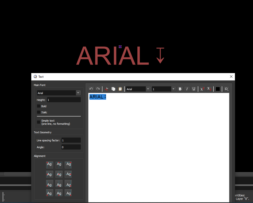

I am a little confused... I also do not see the plunge symbol when I look through the arial font on the Windows Character Map. So what am I seeing here in QCAD?
- arial 2.png (49.8 KiB) Viewed 16835 times
- ARIAL.png (39.76 KiB) Viewed 16837 times

I also observed that behaviour on Windows.
I think Windows does some kind of substitution. Presumably, this also happens in Notepad, Wordpad, right?

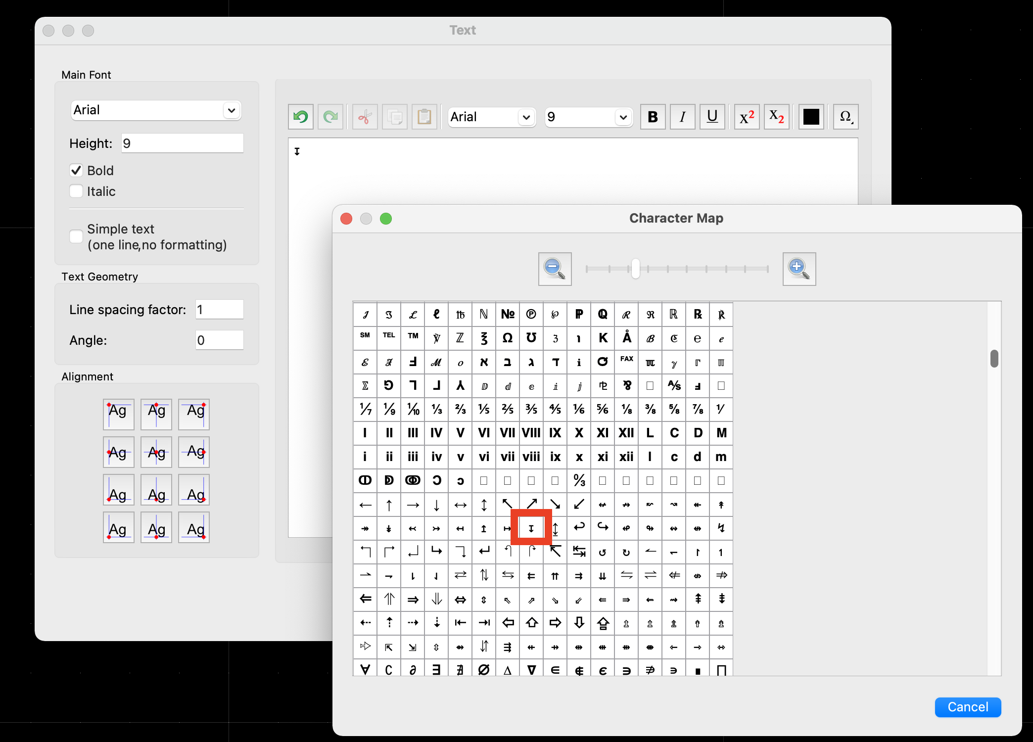

Same thing on my MacBook.
- Screen Shot 2022-05-23 at 10.32.14 AM.png (351.87 KiB) Viewed 16819 times

I'm not a Windows expert but that's how it looks like to me. Try the same thing in Notepad, Wordpad, etc. the glyph will show up even if you are using Arial. It's unrelated to QCAD.ryancousins wrote: ↑Mon May 23, 2022 2:05 pmCan you elaborate on this, Andrew? Is Windows causing the substitution within the QCAD text editor? Are you saying that's why I can see the plunge character even when supposedly in the Arial font?

To be precise, it's the OS that renders the glyph "↑" in font "Arial" onto your screen when the character map is shown, or when you type that glyph into the text dialog or when QCAD renders it as part of a text entity in the graphics view.ryancousins wrote: ↑Mon May 23, 2022 4:10 pmOkay. So it is the OS that populates the "Character Map" that pops up when you choose "other" in the QCAD text editor window?

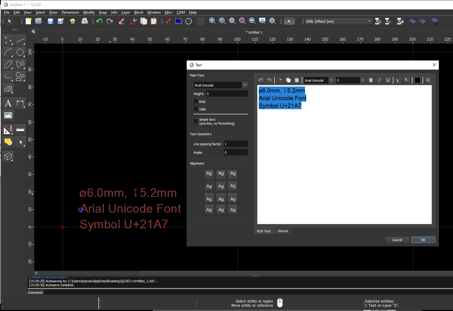

Hi, it looks like the solution was to set the font to "Arial Unicode". It wouldn't render that glyph in "Arial" nor "Unicode". Thanks Husky and all!
The font name at top of the editor did have to be set to "Arial Unicode" several times - it kept reverting to it's default (Cyrillic_ll.) Not sure why it refused and made me pick several times. It's also a little unclear if the left font selector is only for the rendered text (and the right font selector for only the editor text?) But if it were possible to merge both of these font selectors into one control, or default link them, that might be simpler and easier to use. Because I was seeing the problematic symbol just fine in the editor, but not on the rendered page - if the editor and rendered text used the same font, then I'd have seen the issue in the editor and known to change the font immediately.

The two controls do two different things:rdtsc wrote: ↑Mon May 23, 2022 9:04 pmThe font name at top of the editor did have to be set to "Arial Unicode" several times - it kept reverting to it's default (Cyrillic_ll.) Not sure why it refused and made me pick several times. It's also a little unclear if the left font selector is only for the rendered text (and the right font selector for only the editor text?) But if it were possible to merge both of these font selectors into one control, or default link them, that might be simpler and easier to use.
The font selector at the left is the "main font" or "initial font" of your text. If your entire text entity only uses one single font, only use that.
The font selector at the top (and the other formatting controls at the top) apply only to the current selection. To use this, select first the part of the text that you want to be different than the main font and then change the font using this selector.
If your text entity only has one line and only uses a single font and uniform formatting, switch to "Simple text" at the left. The formatting options at the top will disappear, making the text tool easier to use for such texts.
