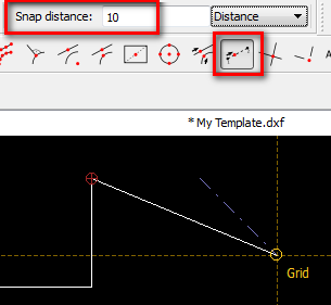

This tool allows you to snap to a point that is between two points, or a given
distance from the first point, at an angle defined by the second point.
It includes a snap distance box and a drop down combo box. The combo box
has three options - 'Distance', 'Percent' and 'Fraction'. So if you entered
50 percent or a fraction of 0.5, for example, it would retuen a point exactly
half-way between the two points.
You enter the value in the snap distance box, and then choose 'Distance',
'Percent', or 'Fraction' from the drop down box.
This command does not restrict the distance, percent or fraction entered.
Therefore a distance greater than the distance between the two points will
return a point beyond the second point. Similarly a percentage greater than
100, and a fraction greater than 1 will return a point beyond the second point.
You can also enter a negative value. This will return a point before the first
point. (Note: You can enter fractions as '1/7', or '3/11' for example.)
The shortcut for this command is DM.
The attached zip file contains the SnapDistanceManual subdirectory.
Extract this to the scripts/snap subdirectory. Then add the
SnapDistanceManual directory to snap.pro, or replace it with the included
snap.pro file.

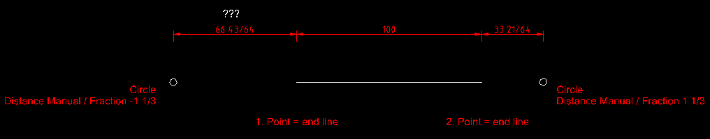

Hi riverbuoy - really nice and useful tool - thanks for doing this!riverbuoy wrote:You can also enter a negative value. This will return a point before the first
May I ask you something what I haven't understood yet:
If I use a positive value like 1 1/3 Fraction I get a result what I have expected.
If I use the same value as a negative, - 1 1/3 or - (1/3), I don't understand the result. Could you please explain how it works correctly.
The second question is: Would it be possible to use the right click on the mouse to go one step back during the first or second point selection to "correct" a wrong point pick?

Hi Husky - Thanks for the feedback and positive reaction.
The command uses RMath.eval function to evaluate expressions. In expressions we
often leave out plus signs. So if we include the plus signs, for positive numbers
it evaluates as +1+1/3 which equals one and one third, as expected. However for
negative numbers what you have is -1+1/3 which equals minus two thirds. So to get
what you expect you need to negate both parts, i.e. -1-1/3, or negate the whole
number, i.e. -(1 1/3).
Hope this explains what is happening.
