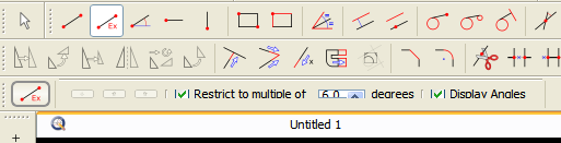

I have made some changes and added new features to the Line command. I think
this is an improvement, but do you? It would be useful to get some feedback.
The shortcut for this command is LX, or use linex or lx in the command line.
The attached zip file contains the Line2PEx subdirectory. Extract this to the
'scripts/Draw/Line' subdirectory.
This does not replace the existing line command, but adds a new line command,
using the same icon, but with the letters 'Ex' added to the icon. In this
instance Ex could stand for extended or expanded line command. But the
features I have added could be most useful to experienced users. However, for
now, it stands for experimental. There is no guarantee there are no bugs in
this command. If you find one please let me know.
I have used 'lupdate' to replace the ts files in the ts subdirectory.

The next feature was inspired by LibreCAD's line command. If you hold the
shift key when selecting a point with the mouse, the angle of the line will
be constrained to the nearest multiple of fifteen degrees.
I thought this could be useful, not only for selecting points with the mouse,
but also when entering distances. At the moment, using 'restrictOrthogonal' or
snapping to grid points, is restricting for using exact angles with distances.
However, I don't want to use the shift key, and I don't want to be limited to
fifteen degrees. So I have added an option to the options toolbar, a button
labelled 'Restrict to multiple of', followed by a spinbox containing the angle
you want to restrict to multiples of. The default is fifteen degrees, but you
can enter any value between 0.0 and 90.0 degrees.
If you set the angle to 0.0 degrees, then you effectively switch off the
command. But you can toggle 'restrict' on and off using the T key, or entering
't' in the command line.
If you set the angle to 90.0 degrees, this is equivalent to using
'restrictOrthogonal'.
When testing this feature, it occured to me that it would be useful to show
the angle of the nearest multiple in preview mode, especially for short line
segments. So I added this feature. However I realised that showing the angle
with every mouse move could become annoying. So I added the 'Display Angles'
button to the options toolbar. You can toggle the display of angles on and off
by pressing the D key, or entering 'd' in the command line. This only works
when 'Restrict to multiple of' is enabled.
If you enter an absolute or relative co-ordinate then 'restrict' is over-ridden
by the co-ordinate. Also the 'close' command ignores the 'restrict' setting.
I hope you find this useful. But also let me know what you think. For example,
is this command now too fussy, confusing or complicated for new users?
