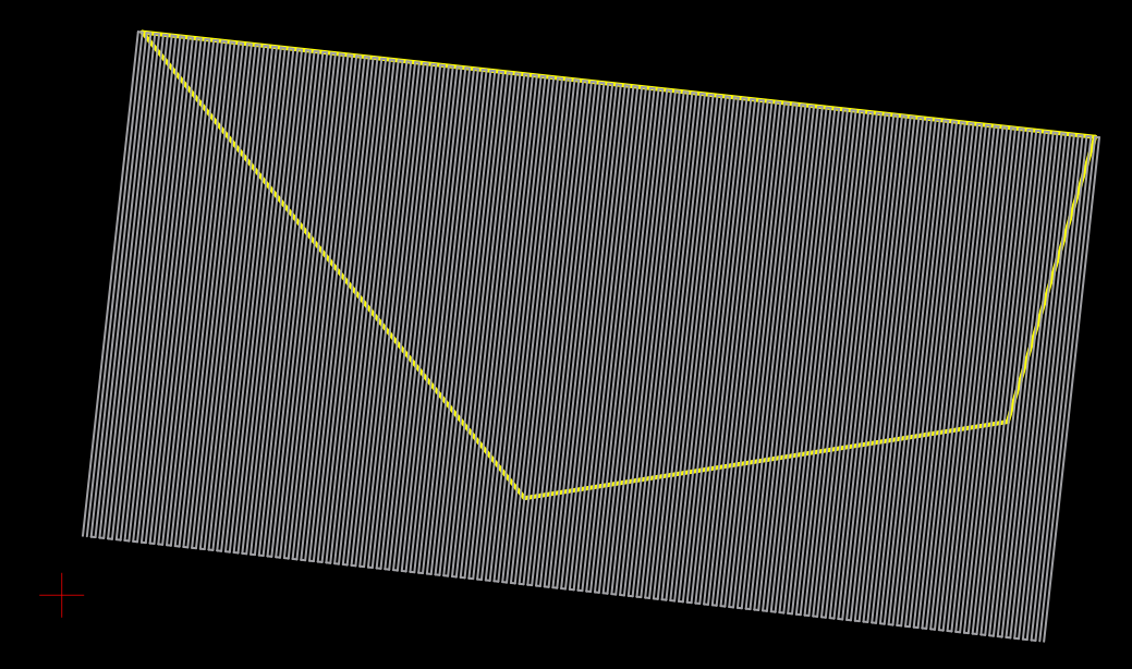

Is there any way to bulk select all the Circuit hatch in the following image outside the irregular closed object and then remove them with "Break out segment" ?
As you can see I already manually removed a lot of the non intersecting circuit by hand, but it would be nice if there is a bulk select possible.
I just do not seem to be able to find such a select option.

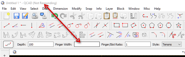

N ow, I go to the "Finger Width" Box and enter nothing. Just a clear box.
Qcad then Hangs in perpetuity.

I can reproduce it with 0 (not shown in input box). Maybe you have to confirm 0 with enter.
QCAD Pro 3.25.2.9, Win10/64
Yes - there is an easier way to do that task. I said easier - not a perfect solution! You are willing to think out of your box? e_confused
Let's start with the angle. Could you live with this angle change?

No, it fails if I try to clear the box default value (with backspace) in order to type in a different number.
It absolutely hangs and pressing anything including enter doesnt help.
See in the video. It already hangs on pressing backspace, and it hangs even before the interface can update an empty field.
When I flip up the menu you can see the black hang image it leaves as QCAD is DOA.
It hangs so bad that it took my entire server down yesterday.
Qcad process became Zombie with excruciatingly high CPU usage and growing memory up to my 64GB maximum limit which crashed the server.
https://i.imgur.com/0LvwTkI.mp4
Notice how the cursor behind 0.5 just dies after the first backspace attempt and so immediate that the 5 is not even updated as deleted.
Hangs solid.
Divide by zero error I assume.
I am using Linux.

Great - looks like you are willing to try something new. I like it!
Ok, I stopped my time to finish that task. It takes me less than 5 minutes and I don't have to do this boring "Break out segments" over and over again ...
This is complex (at the first view!) so I will give you the procedure in small bites, ok?

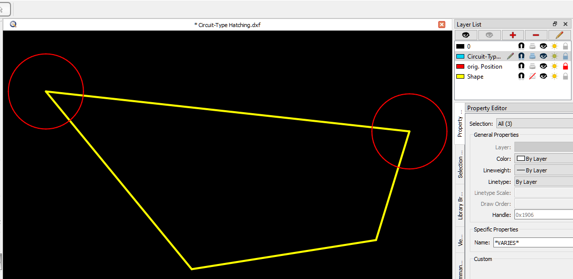

We have to move/rotate the shape on the canvas. To get it later back in the right position we need 2 useful references to make it easy and bullet proof. I use circle in red on a layer called "Orig.Position". Lock that layer.
BTW: I use 3 Layer in total: Shape, Circuit-Type Hatching, Orig.Position.

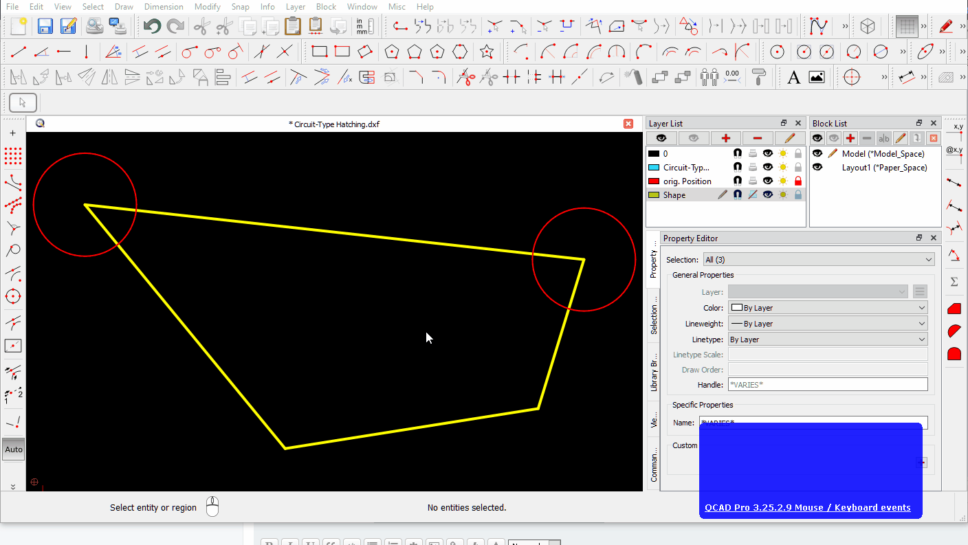

Next step is to get the best benefits out of the "Box Joint from 2 Points". Best thing would be to align it horizontal with the longest line in our shape. For that we have to rotate the shape before we use the Box Joint tool. I used additional the "Alt" key to restrict the tool to 90 degree steps.
Circuit-Type Hatching task stepbystep_1.gif (5.4 MiB) Viewed 21167 times
Just to be on the safe side I extended the Box joints on the left and right side ...
Ok, one done three to go ...
Tell me when you are at the same status and I'll give you the next step.

Now how do I delete all the unwanted circuits at the bottom in one or minimal number of actions?
Re: Feature Request. Circuit-Type Hatching.
Post by Husky » Fri Jan 29, 2021 7:16 am
TreestumpExhaustpipe wrote:
Fri Jan 29, 2021 1:35 am

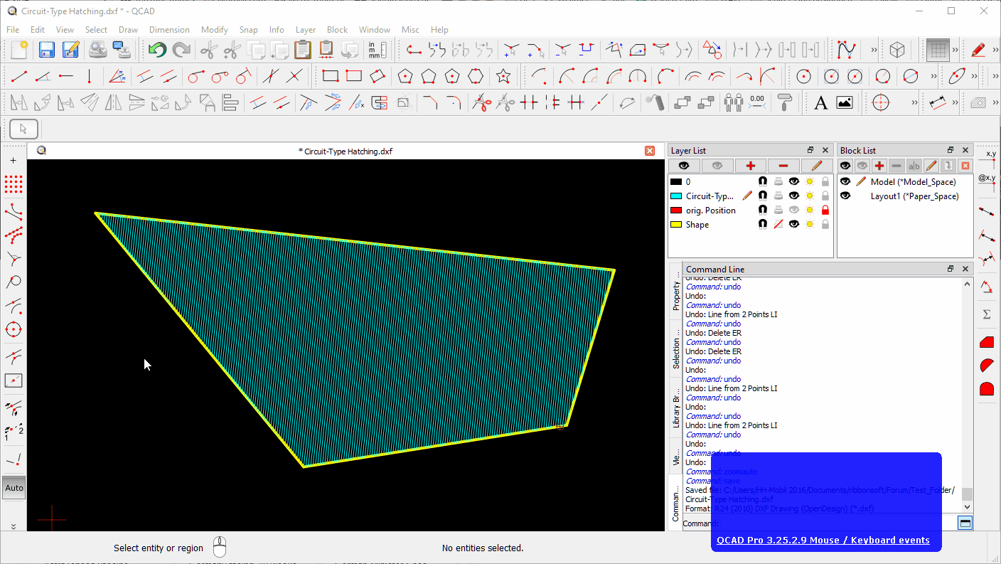

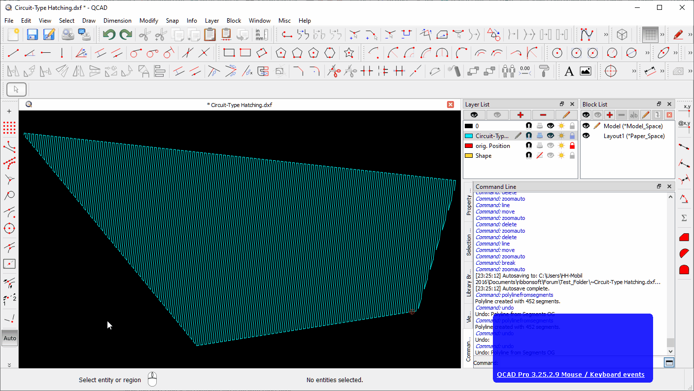

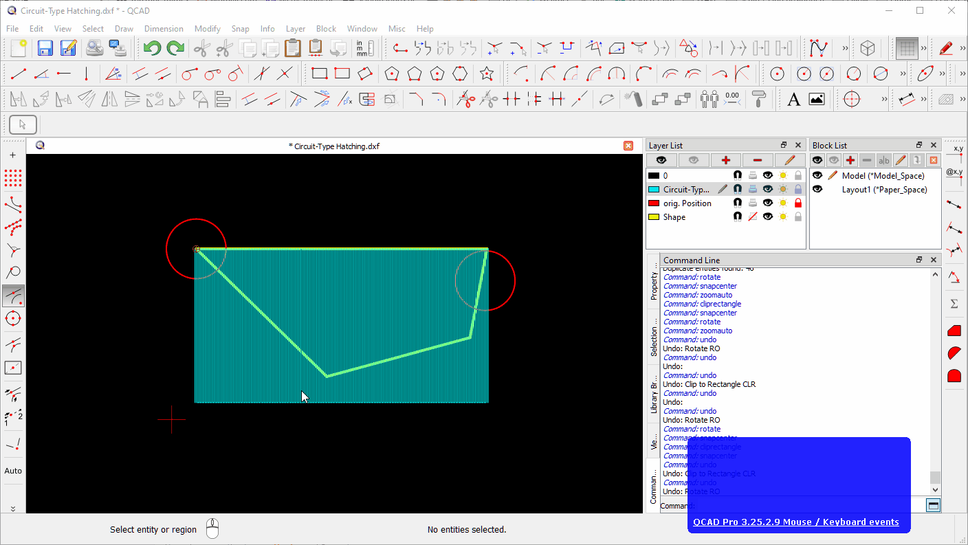

With the use of the "Clip to Rectangle" tool. Unfortunately the tool provides currently only a rectangle shape which is limited to a vertical/horizontal orientation. Well, we have to work with that what we have ...
To make it workable for us we have to rotate the Circuit-Type Hatching into a useful horizontal or vertical position ...
Circuit-Type Hatching task stepbystep_2.gif (9.12 MiB) Viewed 21154 times

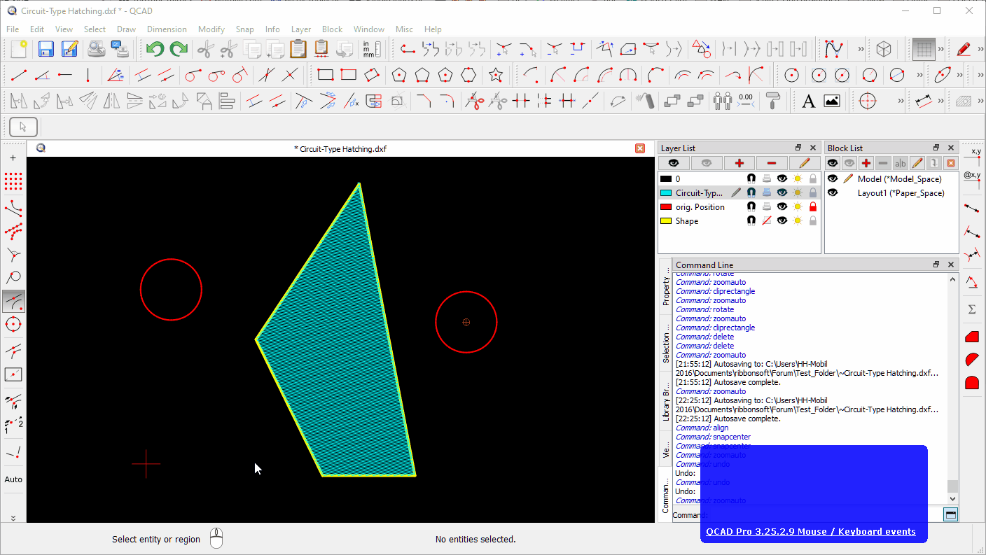

Next step - bring the shape back to the original position / orientation...
I used the "Align Reference Points" (AE) tool ...
Circuit-Type Hatching task stepbystep_3.gif (3.54 MiB) Viewed 21148 times
