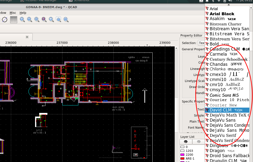

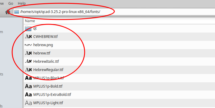

Something strange is going on. I downloaded the fonts and copied them into the 'fonts' folder:
Yet on the sheet (after restarting QCAD) there is no option to choose any of those fonts (except for one, which doesn't work). For example I want to try CWHEBREW.ttf, yet it's not present:

Post by CVH » Sun Jul 11, 2021 7:47 am
shim wrote:
Sun Jul 11, 2021 7:29 am
Can't help you there. Maybe a reboot ...
Have you tried to include them under the QCAD fonts folder?
Handy when you don't use them system wide.

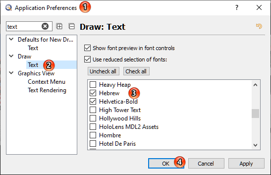

Re: Support for Hebrew fonts (.shx)
Post by Husky » Sun Jul 11, 2021 7:48 am
If you use in QCAD the option to reduce the font selection then you need to tick that font to make it available within QCAD.
Edit: I'm not on Linux but I think the font needs to be in the system font folder and not in the QCAD font folder. At least that is how I did it on Windows ... :oops:
