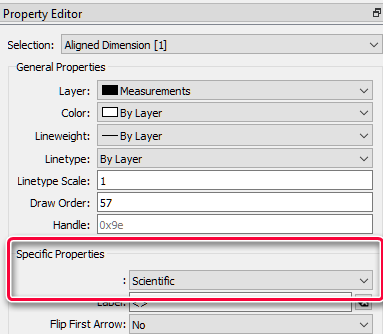

@wendi: Something went wrong with your drawing dim settings - overwrite it with the same settings and it will work as expected.
Open drawing,
Right click on Layer "Measurements" and select all measurements on that layer,
Check the Property Editor for "Specific Properties".
The first field (which should be named "Linear format:") shows a setting named "Scientific". Use the drop down and change it to ...... Scientific. Yes, I'm not kidding or drunk - that is the correct "new" setting. Note: It needs to be new selected to get it to work! :wink:
Now you should be back to normal. Keep us posted. :wink:
Observed that too in the screenshot by wendi (in second place).
That would reflect that something is broken in the Property Editor naming ...
Has that been resolved with the proposed re-entry?

Thank you again to CVH and Husky. I selected all of my measurements, and changed the unnamed property from "scientific" to "scientific" as Husky suggested, and all of my fonts went to the same size! It worked, but... all of the arrow styles changed from "arrow" to "architectural tick!" New measurements correctly used arrows, but nothing I tried would change the existing ones. So all things considered, this "fix" is problematic.
Clearly, something has gotten out of whack in my drawing. To be honest, I realized days ago that I could simply delete and replace the measurements that had the incorrect font, but I wanted to understand what was going on, and I viewed this as a learning experience. Having now spent several days on it, and of course, taking up a lot of time from generous strangers, I think it's best to stop spending more time on this. I fear we may be chasing multiple problems, and will never get to the bottom of it all. I will simply replace the erroneous measurements, and move on with my project. Again, I really appreciate your efforts, and thank you all for your time. Wendi
