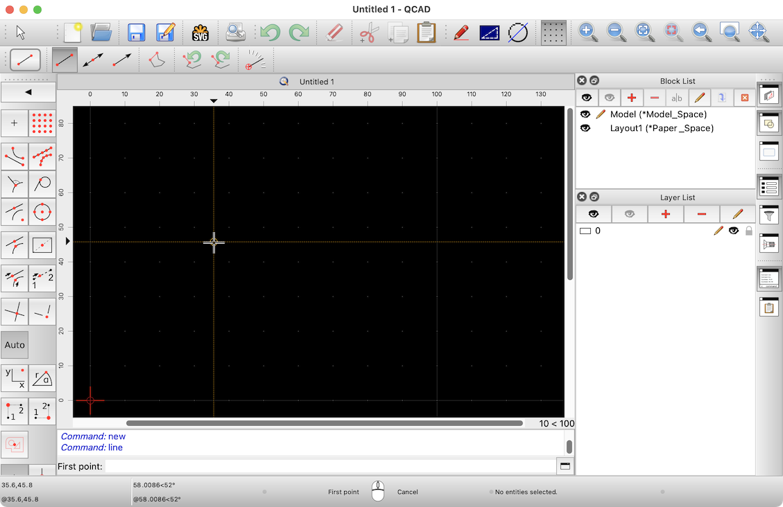

The crosshairs mouse cursor should look like shown below. If that is not the case, your system settings might scale up all mouse cursors.
The mouse cursor is the little white cross.
The yellow crosshairs show the current snap position.
You can change the white cross to the system cursor under:
Edit > Application Preferences > Graphics View > Appearance > Cursor > Use system cursors
You can switch off the yellow cross under:
Edit > Application Preferences > Graphics View > Appearance > Cursor > Show crosshairs
Screenshot 2023-07-24 at 08.05.04.png (189.49 KiB) Viewed 4131 times
