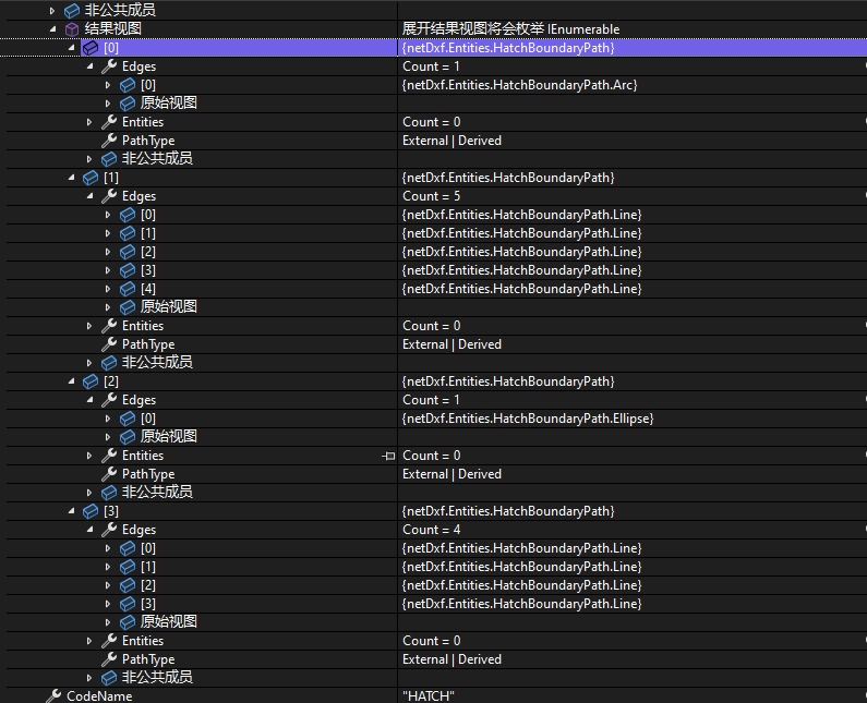

Hello everyone, the attachment is a DXF test file I designed, which contains a hatch area. I am now using the winform netdxf library to parse this DXF file. The obtained hatch entity contains four netDxf.Entities.HatchBoundaryPath objects, but I don’t know this. Which two of the four objects need to be filled and which two do not need to be filled? Is there any flag or method to distinguish them? I need to display the filled area in winform program

Re: hatch problem
This is an island in an island in an ... problem.
You have to determine what HatchBoundaryPath is (fully) inside the other.
Easy for humans to do that: [0] is inside [2], [2] is inside [1] and all that is inside [3].
The QCAD hatch engine does this automatically given some rules of engagement to render a hatch.

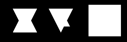

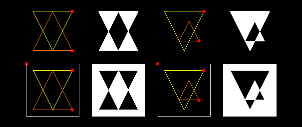

The 2-3 Loops below are not complicated, each one is a simple convex polygon.WildWolfCJ wrote: ↑Tue Nov 28, 2023 3:05 amFor hatches, I don’t need to consider too complicated scenarios
Not when the loops are intersecting. Then the enclosed area of a single loop may be filled but also not filled.WildWolfCJ wrote: ↑Tue Nov 28, 2023 3:05 amEach filled area is determined by two HatchBoundaryPaths.
The minimalistic approach will not work there both startpoints of the yellow and orange loop are not inside the other.
On the bottom row the yellow and orange loop are both 1 level inside the white loop.
Because you make the assumption that it is a simple pairwise relationship what is only the case for trivial layouts.WildWolfCJ wrote: ↑Tue Nov 28, 2023 3:05 amMy problem is that I cannot determine the HatchBoundaryPath pair corresponding to each hatch.
You first need to establish that it is indeed a trivial case.
Some examples:
With a simple flag (Not supported by QCAD) the resulting hatched areas may look like the examples below.
Bottom line, DXF only stores the geometry of the loops, what can be in any order.
It is up to the application to render the hatched area as required.
