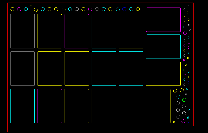

Our team is currently tackling a project that involves utilizing QCAD/CAM for the preparation of .DXF and .SVG files intended for nesting. We've hit a snag due to open contours in our files. If a contour remains open, the nesting command disrupts the integrity of the piece, leading to the program running indefinitely. It's crucial for us to verify that all contours are sealed before proceeding to the nesting phase to circumvent this issue.

Does anyone have experience or knowledge on how to effectively identify open contours within .DXF and .SVG files using QCAD/CAM? Furthermore, is there a specific parameter within the nesting command that can help avoid this problem?
For context, we are operating on Ubuntu 22.04 running in a docker, utilizing QCAD version 3.29.3 pro-linux-x86_64. The process is tailored for arranging pieces into various trays

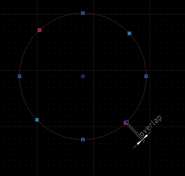

Normally, for these types of drawing, I'd recommend to work with polylines to ensure that all contours are closed. However, your drawings have overlaps which makes this difficult:

Indeed very remarkable ... Consistent in their distance between endpoints equal to about 0.300.
But after some investigation most consistent in the Arc length ... The length along the curve of the arc:
Varying only in the last digit: 0.29999998 - 0.29999991 - 0.29999993
What is a match with the linear overlap of 0.30000000 for the outer contour.
I also detect other not near rounded values probably originating from a single precision system.
May I ask what the source of these shapes are ?
I can think of one source that fits.
G1 and G2/3 moves in G-Code with a 0.300mm overcut (The file is in drawing unit 'None')
And that may fit with the single precision notation too.

Thank you very much for the replies. The overlaps are a result of the manual creation process; they are likely to be inconsistent and vary slightly in dimension and position. This is repeated in every piece that we are analyzing. Thus, it is something we cannot avoid because we do not make the pieces; they are sent to us to be nested into tray dimensions.
The nesting is done using multiple copies of that piece or different pieces. To do this, we use a program that creates a new .dxf file where all the pieces for nesting are grouped, and we assign each piece to a layer. For example, if there are four copies of the same piece, each piece corresponds to one layer. We also add a layer called "tray" because the nesting has to be done within that tray area. Therefore, the merged .dxf file has the layers: "tray," "piece1," "piece2," "piece3," etc. In the image, each color corresponds to one layer, therefore still to one piece, and it still does not consider it as a whole entity.
It is the client's responsibility to check that the piece is well-drawn, but human mistakes can happen, and we want to detect those mistakes. Is it possible to automatically detect overlaps in ARCS, POLYLINES, LINES, etc.? And if so, can detecting overlaps ensure that the piece is fully closed? Is there a tool to automatically connect line segments and arc segments and fix the piece so the nesting can be done? Is it possible to do it with QCAD, or do we need another tool?
