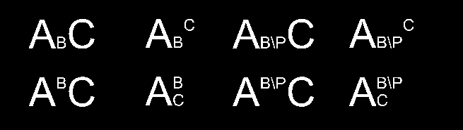

It fails in general with a newLine in combination with sub/superscript (4 rightmost examples):
Normal supper-subscript and newLine.png (3.89 KiB) Viewed 74987 times
