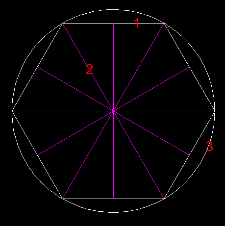

1. Draw a Hexagon, call the Polygon tool;
Line Tools > Polygon and select either polygon (Center point PG1) or Polygon (Two corners PG2).
Enter 6 in the Corner field.
2. Divide Hexagon into 12 equal parts, set up a new layer to do this (Layer Construction, color Magenta).
3. Draw Circle ( circumscribe -outside) using one of the Hexagon corner points for a radii reference.

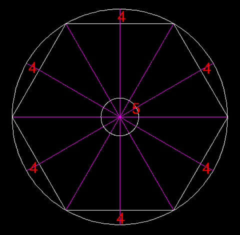

4. Extend all construction lines to meet Circle circumference.
5. Draw 2nd smaller Circle from center point.
Draw a Rose window 2.png (15.46 KiB) Viewed 12468 times

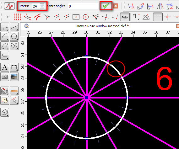

6. Split smaller Circle into 24 equal parts:
Select Circle > Modify > Split Entities - enter 24 in the Parts field and tick the Green tick to finish the process.
Draw a Rose window 3.png (16.83 KiB) Viewed 12468 times

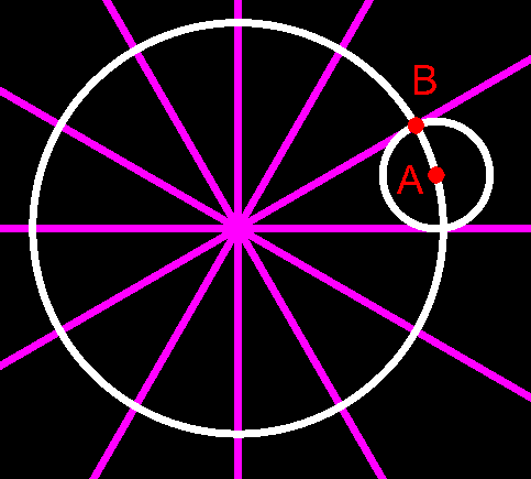

7. Draw smaller Circle to fit perfectly between center (End part 'A') and intersection 'B'.
Draw a Rose window 4.png (5.9 KiB) Viewed 12468 times

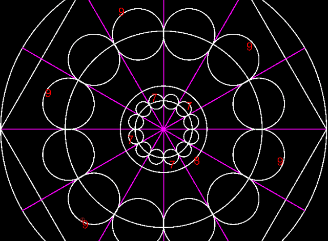

8. Copy and paste Circles to fit (7).
9. Draw a border Circle (8).
10. Repeat process to draw another larger Rosette. (9).
Draw a Rose window 5.png (36.57 KiB) Viewed 12468 times

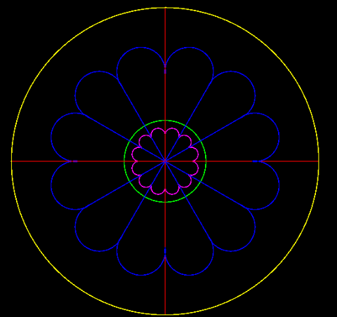

11. Finally 'clean up' the drawing using modify tools - 'Break out segment' and the Delete tool.
* Change the construction layer to a color that suits!
Should be job done :wink: .
Draw a Rose window 6.png (15.95 KiB) Viewed 12468 times
