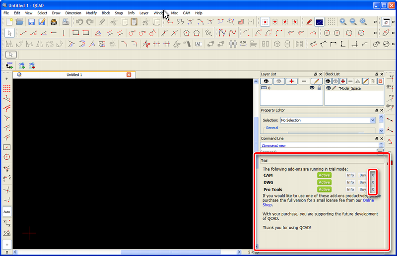

On the right end of each line you will find the "X" to delete the add-ons.
If you decide to remove a trial add-ons just click the "X".
A dialog will pop up which will ask you to restart QCAD. If you decide to remove all three of them you don't need to restart QCAD after deleting every single add-on - just restart QCAD after you are done with deleting all three add-ons.
Thats it.
Enjoy QCAD
If you start QCAD you will see in the right lower corner a "Trial Window" with the "CAM", DWG and "Pro tools" add-ons.JackErbes wrote: - To uninstall a trial add-on, click on the button with an 'X' beside the add-on in the 'Trial' window.

I run windows10 64 bit. I was having trouble removing the trial window as well. There was no "x" to click. Everytime I clicked removed and restarted the trial window would be back. I couldn't find the file names listed here to remove manually. Here is what I did that worked.
After installing qcad, RIGHT click over the shortcut icon on your desktop. That will bring up a context menu.
Next left click "Run as administrator"
Next left click "yes" to allow the app to make changes question.
Now click the "remove" next to the add ons, then restart qcad.
Now the trial window should be gone.
