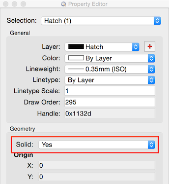

- Delete three of those hatches and change the last one to solid:
Screen Shot 2015-06-03 at 10.37.30.png (60.95 KiB) Viewed 20648 times
- Export to PDF -> file size will be about 150kB

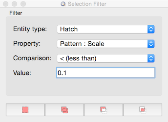

The selection filter can be useful to find such hatches:
View > Selection Filter
Screen Shot 2015-06-03 at 16.45.24.png (33.92 KiB) Viewed 20632 times
