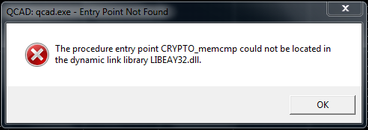

QCAD on Windows 64bit shows the following error:
The procedure entry point CRYPTO_memcmp could not be located in the dynamic link library LIBEAY32.dll.

It looks like QCAD (or rather the Qt library QCAD is based on) is trying to access and use a broken OpenSSL installation on your system.
You can download prebuilt packages of OpenSSL for Windows from http://slproweb.com/products/Win32OpenSSL.html
If you are on a 64bit Windows system, you might want to install the 64bit version of OpenSSL.

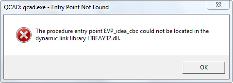

Going to try an experiment and find the most upto date (by file date) LIBEAY32.dll on my system and copy it into my QCAD installation, hoping Qcad uses that one first and solves my problem ? Tried this with ver 1.0.2.1 of the dll, and the error message has altered. Would it be possible in a future release to add the required correct .dll in the installation of Qcad as going to be tricky to find one that works ? Thanks.

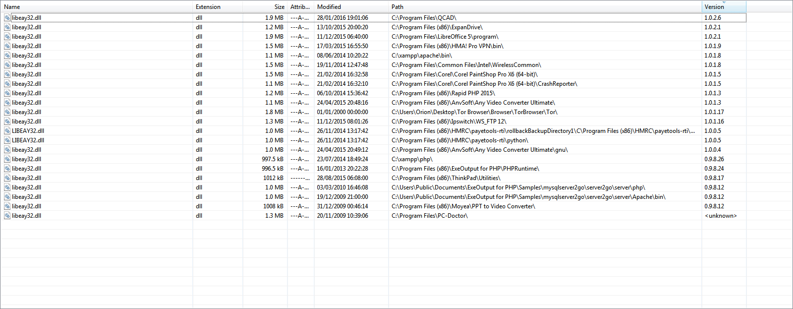

Hi Andrew, that particular libeay32.dll file is common place (if not the version) and used in many packages (apache, ftp, vpn software, graphics software, even my company tax paye software hehe) not directly related to openssl (see screen capture of my laptop files), and didn't have problems with the previous version of Qcad pro - same software installed. But by putting that latest .dll into the Qcad install folder has fixed my problem... suspect will have to do it again on a future upgrade.
