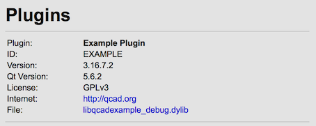

To check if your plugin has been loaded successfully, check Help > About... > Plugins:
Screen Shot 2017-03-24 at 16.06.15.png (35.96 KiB) Viewed 10332 times

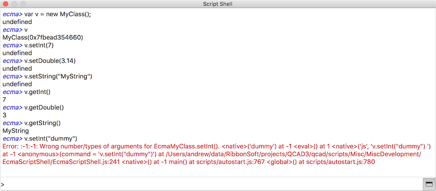

You can use the script console to test your class:
Misc > Development > Script Shell
Screen Shot 2017-03-24 at 16.02.06.png (133.11 KiB) Viewed 10332 times
