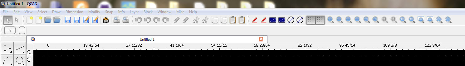

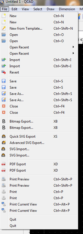

Good day,
I just purchased and downloaded the Pro version of QCAD and have duplicate toolbar and menu items. My info is as follows:
Win 7 Pro 64-Bit
QCAD 3.22.1 64 Bit Version
Installed via the Windows 64 bit installer today (2019-06-19)
Attached are a couple of screen shots showing the duplicated menu and tool bar items.
Thankfully the duplicate entries still function correctly (as best as I can tell), but are inconvenient. Can someone let me know how I can remove these duplicated items?
Cheers,
Sam

QCAD Pro 3.22.1 Win7 64 Duplicated Menu and tool items
- SNAG-0070.jpg (65.22 KiB) Viewed 5640 times
- SNAG-0071.jpg (88.75 KiB) Viewed 5640 times

Re: QCAD Pro 3.22.1 Win7 64 Duplicated Menu and tool items
Good day All,
Another update... I decided to fully uninstall both the older version and the new version, then reinstall the new version. This seems to have corrected the duplicate menu and tool bar items ... and more importantly I am able to delete lines... Yippee!
So... It looks like one has to deinstall any previous versions first and then do a fresh install.
Cheers,
Sam
Cheers,
Sam
- Posts: 8769
Usually this is not needed. But when updating from a much older version or a version that was not installed from an MSI (but from a ZIP archive), then removing the old installation is advisable, yes.
Anyway, glad you could sort it!
