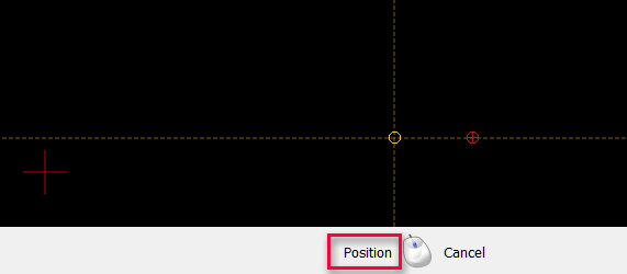

Correct. If you need something is asking you for the position then you should make the Status Bar visible. You can find it below Menu/View ...
