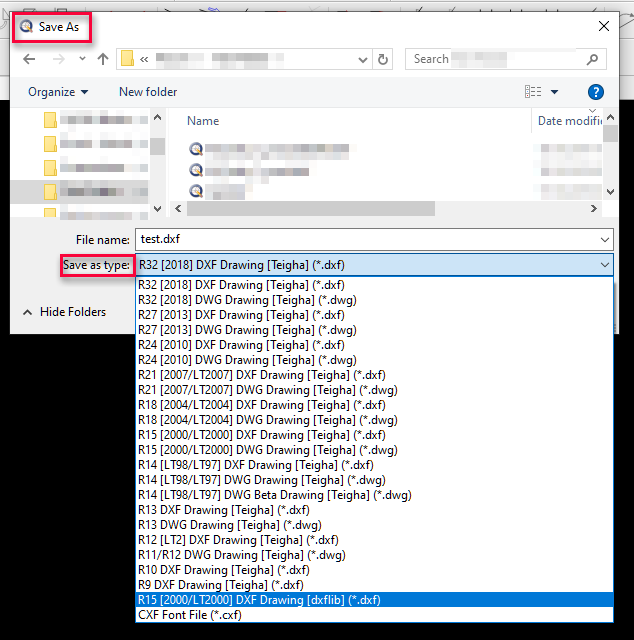

As for the Student stamp Bug I got a reply back from one of the developers see his reply below:-
This seems to stem from an OpenDesign Teigha 4.3.1 bug when DWG 2018 is used. This can likely be fixed for the next release when we upgrade Teigha. For now you might want to use a different DXF/DWG file format version than DWG 2018.
Andrew Mustun
As for the Layer 0 not printing I never had this problem with the free version of Qcad which saved only in R15 [2000LT2000] DXF Drawing [Teigha] (.dxf)
I wanted to save in this version by default but the professional version only allows you to set your default format to as far back as
R18 [2004/2004LT] DXF so what I did was edit Qcads config file and changed the following:-
Copy and paste this into SaveAs part of config file:
Filter=R15 [2000LT2000] DXF Drawing [Teigha] (.dxf)
Most of my customers use AutoCad and to have them call me and say they had to edit all my dxf files because they couldn't print them
was slightly embarrassing.. So now my files all save as R15 [2000LT2000] DXF Drawing [Teigha] (.dxf) by default
by the way the config file is in the %appdata%\Roaming\Qcad "Folder"
I set mine to read only after the edits as I have Qcad setup as I want it now..

Howsoever - you are still able to save a drawing in an old version (even R15) within the "Save As" dialog ...
... and for obvious reasons I do not recommend to edit the config file manually.
Suggestion: Andrew told you not to use R18 - he doesn't told you to use R15, correct? What's about to use R27 (around 7 years old)? Most likly your AC customer are able to read R27. If not, just ask them which format works best for them except R18.
If possible don't go down to R15 - that isn't contemporary
Just my two cents.
Properly there is a reason not to offer anymore a 20 year old version ....John Hyslop wrote: ↑Sat Oct 19, 2019 4:58 amAs for the Layer 0 not printing I never had this problem with the free version of Qcad which saved only in R15 [2000LT2000] DXF Drawing [Teigha] (.dxf)
Embarrassing? No, no reason for that! That is called the "Blame game" and you have to be very good in this game to avoid a backfire.John Hyslop wrote: ↑Sat Oct 19, 2019 4:58 am

Version 2000 DXF is the only version that prints from autocad layer 0 set to white as default..this is the only reason I've set it as default..I know you can save as ver 2000 but if I forget it doesn't print... don't get me wrong here I think qcad is a brilliant program.. I've used autocad for over 30 years and now switched over to qcad professional version...I only use for 2d for 3d I use Autodesk Inventor...As for the configuration file if for some reason you happen to make a mistake you can simply delete it and qcad will create a new one on next startup...all you need to do then is setup all your preferred settings again..

There's a snapshot release available (3.23.0.5) with the latest Teigha version (hopefully fixing the student version stamp bug).
This snapshot also saves white layer colors as index 7.
Snapshots are packages with the current development version of QCAD. Snapshots should be considered unstable and are not intended for production use.

Re: Qcad Layer 0 Not printing from Autocad + Stamp Bug
Hi Andrew
Just tested these DXF and DWG formats on Autocad 2020 .
Ver 2000
Ver 2004
Ver 2007
Ver 2010
Ver 2013
Ver 2018
The file contained arcs lines circles polylines and splines.
Layer 0 Colour imported as Index 7 white.
Also changed background to white and the entities appeared as black on white..
All versions printed correctly
The Student Stamp has gone too..
Great work thank you..
Ver 2000
Ver 2004
Ver 2007
Ver 2010
Ver 2013
Ver 2018
