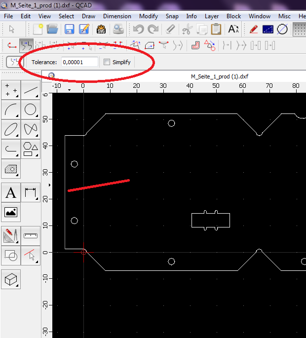

Re: cannot find disruptions of outer contour
Same contour again...
In your dxf.
Draw / Polyline / Polyline from Segments OG.
Tolerance very low but larger as 1e-6 eg 0.00001.
Simplify No.
Point at lefmost vertical.
Qcad will find all properly connected and create a Poly string.
Where such a string halts there may be a problem.
Your string looks almost closed except it is not a perfect geo closed form at start and endpoint.
Zoom in using screen-based linetypes.
The vertical piece inside Panchdara circle does not start at y=45 but at y=44.988519
The placement of the arc and line are correct.
Use Trim Both.

- Posts: 4997
See pic
A practical no-nonsense type and a lazy one.
Sure near perfect. Very near.
Start and end where 0.011481 units off.
- OG_Poly_Prefs.png (64.53 KiB) Viewed 20371 times

So before hatching first set your active layer to create the hatch on.
The by segment method is strong in that it takes the entities you select up to the next intersection.
By this you can create a boundary without that you have to create that boundary for real from parts of your entities.
In your case it would mean you have to select all parts of the boundary yourself.
Not a good solution for this.
The by selection method expect that a selection exist before you activate the tool.
"leader-tool"
Dimensions / Leader DE
A leader is a dimension type that points to something with an arrow.
"coordinate-function"
Just one of the many ways on how to define a position.
I encourage you to try this for real step by step.
It's no rocket science.
With the first file in this topic:
File open
Add Layer 'Hatching' (also becomes active)
Select all
Draw / Hatch / from selection HA
Nothing happens...
On the command line you will find in red:
Loop not closed at point 145.6/45.
Lets point at the position in question:
Click anywhere in the dark to unselect all.
Qcad now expect us to provide a position for the arrow tip.
By pointing, snapping or whatever.
We want to use 145.6/45. literal.
The command line says:
Arrow position:
Type 145.6/45. (Use the preferred decimal point and list seperator)
Hit Enter.
Now your arrow head is locked at 145.6/45. and you may place the other coordinates with a click.
What you are drawing with the next clicks is in fact a polyline with line segments.
End with 2x Right-click (Done, Cancel)
When we zoom in on the arrow head it gets confusing past grid 0.01 units.
Select Screen Based Entities or draft mode.
Select the arc and the vertical line.
Zoom further untill you see the vertical line sticking out.
Unzoom a bit.
Problem solved with Trim Both.
Select and delete the Leader.
Select All.
Success.
As your boundary is accepted by the hatching tool it will be sane.
Keep the hatch or hit Undo.
That is for one problem.
If you have more issues it starts all over again.
Thats why I prefer the poly from segments method.
With a few clicks near larger entities you have allready some proper connected poly strings.
Selecting these strings will show you where they end and by this where they failed the tolerance.
