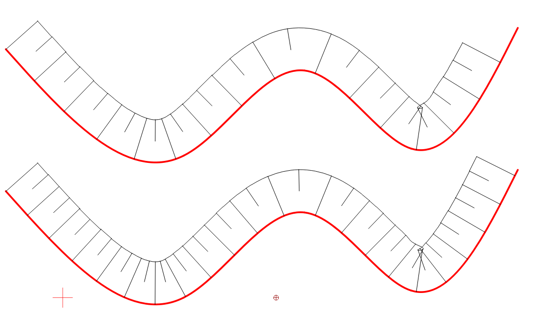

Gave it a little more thoughts and here comes the second catch.

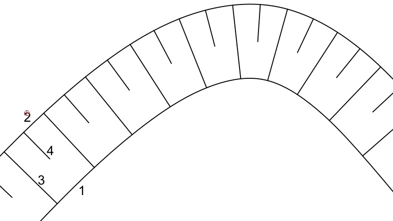

Flexpainter is merely stepping the base-entity and projecting references orthogonal.
In your picture I can clearly see that the equidistant stepping is on the so said parallel 2).
Flexpainter can't do that in one go. :(
The so said parallel is created at the end from the tips of the spokes by one spline.
simple bank painted.png (72.97 KiB) Viewed 5441 times
And cleary visible is the smudging when the bend is to hard inwards.
The other way around would be.
Drawing a 'Real' parallel 2) and only paint spokes....
Then all depends on how good the parallel is. :roll:
The spokes will not adapt to any flaw in distance.
Let me know. :)
