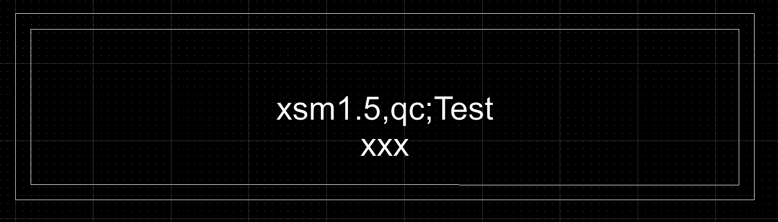

I open my DWG drawing in AUTOCAD, the font was ok.
But when I tried to use QCAD, the font was something wrong.
P/S: I'm using QCAD in ubuntu 19.04.
Font Size Mising
Screenshot from 2020-01-05 10-03-25.png (7.25 KiB) Viewed 10685 times

Post by jssham » Mon Jan 06, 2020 11:35 am
This is what I expected.
From AUTOCAD
From QCAD
Screenshot from 2020-01-06 18-33-30.png (19.84 KiB) Viewed 10604 times

Thanks jssham. Makes a lot more sense. Can you save the original (Autocad version) in DXF format? Looks sorta like an import issue? I'm sure Andrew will figure out - I was just trying to see where the differences were. I guess ACad might save DWG files using their proprietary format(s) and even then their formats might differ from version to version.

Post by andrew » Mon Jan 06, 2020 2:04 pm
Autocad uses various text formatting codes, some of which are not supported in QCAD.
"\pxsm1.5,qc;" is such a code. I haven't seen this before with the ",qc" part. I've added this to be ignored in future versions to avoid displaying the code itself. There are currently no plans to add support for individual text line spacing through these codes.
