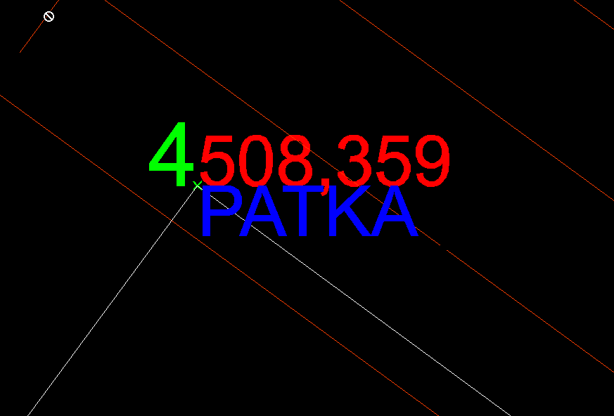

import coordinates including point number, height and code
Hello.
This topic appears more often here (topic for land surveyors), but I did not find a solution. I'm trying use QCAD instead of Bentley products. I need import a list of measured points (txt file) in the format "point number", "Y", "X", "H" and "code". QCAD is 2D sw, so number, height and code can be displayed only as text (number to the left of the point, height at the top right, code at the bottom right). And optimally so that the number, point, height and code are in a separate layer. I can import points using the link https://qcad.org/en/tutorial-using-a-li ... oordinates, but that's not enough for my purposes.
Please help with the solution.
Thank you.
Thank you.
- solution in MicroStation
- MicroStation.PNG (17.2 KiB) Viewed 16582 times

Re: import coordinates including point number, height and code
OK,
scripting is the way. I managed to solve my problem for one point. It's a good start, now the hard part - how to do it from input file.
The following set of commands creates layers, creates a point, and the desired text descriptions.
Tomek.

tomek
- Posts: 13
- Joined: Mon Jul 13, 2020 1:23 pm
- Location: Czech Republic
I was busy for a long time. However, below is the code for the required function (for other surveyors). GUI and other options (quadrant selection, attributes, coordinate order) would be desirable, but the basic functionality is solved. Thanks for the help.

Great,
two things:
A) On this forum one can use a code plane (in editmode, above, icon 5)
(And you can edit your previous posts
B) You should at least choose a unique script and function name.
Why not ImportSurveyorPoints?
For this you change any text 'ImportPoints' in the new name.
Next adapt the init section:
ImportPoints is 52100/100, MOL import 52100/200
The choise is yours 150 or 300
new RGuiAction: Adapt textual, the '&' is for the key-in navigator
Extra's: (but none is really required)
If you use it fairly often or when testing I add "MainToolsPanel" to the list setWidgetNames.
Finally, put your script under a subfolder of folder 'MiscIO' with the same name as the script except the extention.
Keep us posted.

Now I come to think of it ...
I don't see startTransaction(...), nor endTransaction()
It's faster as a group and meanwhile it collects your castings in one operation one can undo in one go.
See: simple_transaction.js
The 'simple' form of operation.addObject(point); is addpoint(v);
You can reuse var v for any new RVector(parseFloat(coordinates[1]), parseFloat(coordinates[2])) that follows.
Andrew has not the habbit of putting more commands on one script-line.

QCAD 3.26.4 comes with a new tool to import point data with labels from CSV:
