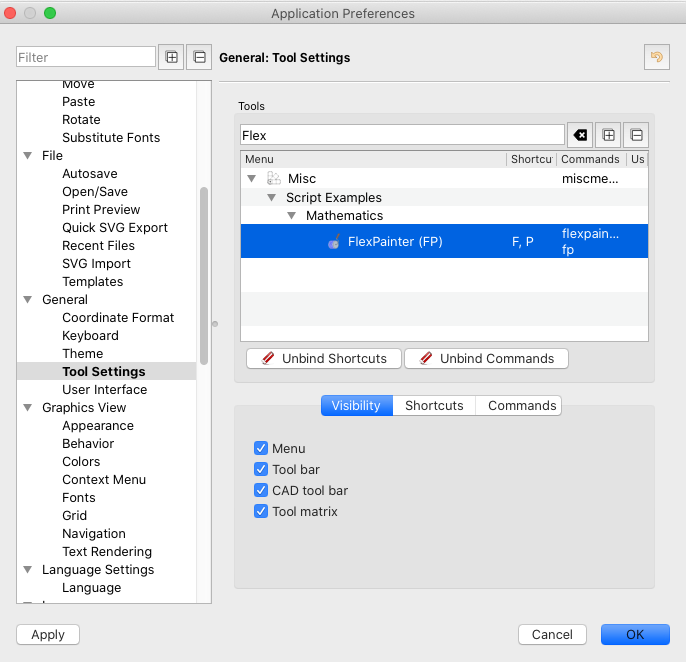

I'm using QCAD with macOS 10.15.7.
Why is it not possible to display the FlexPainter in the tool bar, in the CAD tool bar or in the tool matrix?
I like to use the FlexPainter and have to click through the menu structure "Misc / Script Examples / Mathematics" every time. Of course, I can also achieve my goal with the key combination FP, but it would be better if the FlexPainter could also be reached more easily via the various tool bars, especially since a menu item in the application preferences implies this option.
FlexPainter visible in Tool Matrix
- Tool Settings FlexPainter.png (84.17 KiB) Viewed 6124 times

- Posts: 8785
Re: FlexPainter visible in Tool Matrix
Your download "FlexPainter 42e.zip" adds this tool to ["MathExamplesMenu"]. By all means feel free to change that to ["MiscDrawMenu", "MiscDrawToolBar", "MiscDrawToolsPanel", "MiscDrawMatrixPanel"] if you prefer. Who exactly "didn't allow" you to do that?
As CVH suggested, just use the fp shortcut, much quicker than using any menu, spacebar, f, p, three quick key presses

- Posts: 4955
As volunteer, I asked the permission to do that.
I have no rights in the QCAD Pro project at all.
Without direct permission, it is nothing more than a fairly simple and basic Math script example.
The place in the QCAD project is governed by the script Init code and fixed.
