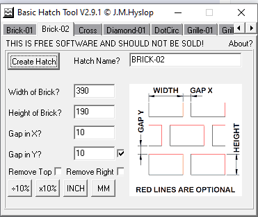

Here in Australia Concrete blocks are 390 mm long x 190 mm high. Mortar joints are 10 mm.
I need to place hatching that matches these exact dimensions.
I have never created a hatch pattern before.
Does anyone have a hatch pattern that matches these sizes or point me to a source or instructions how to create them.

Lucky you! I think a neighbor of you has a good solution for your problem :shock:
John Hyslop, a member of this forum, created a hatch pattern tool which can do exactly what you are looking for. The tool is called:
"Free Stand Alone Basic Hatch Pattern Tool" ...
... and can be downloadet from here:
viewtopic.php?f=30&t=6944&p=31023#p31023

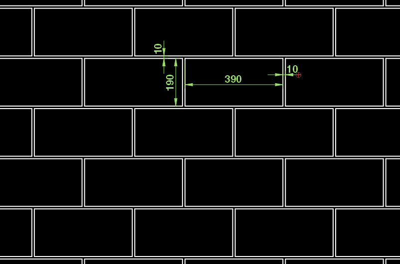

It will help you without coding skills to design a hatch pattern like this one:
I used his tool already many times. :wink:
seasdes
Senior Member
Posts: 137
Joined: Tue Jan 26, 2021 2:01 pm
Re: Concrete Block Hatch For QCAD Pro
Post by seasdes » Mon Mar 01, 2021 7:40 am
Thank you Husky and especially John.
What an excellent utility.
