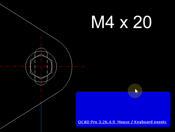

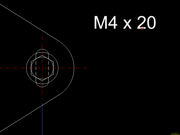

Right now the script uses the following user input.
Select text,
launch T2L script,
select the created leader,
manipulate the arrow position.
T2L original.gif (275.1 KiB) Viewed 83913 times
I thought if you could change the order for each step it would be more efficient for the workflow. I'm not a coder - no idea what is possible and what not but I assume most of what is needed is already in your script ... :oops:
Based on the already in QCAD existing leader I would appreciate this workflow:
Launch the T2L tool,
place the Arrow tip to the right position, leader line of the arrow is a Line from 2 point (rubber line),
select the text,
based on this information the tool will built the leader.
Something like this:
T2L proposition.gif (251.43 KiB) Viewed 83913 times
What do you think about this?
