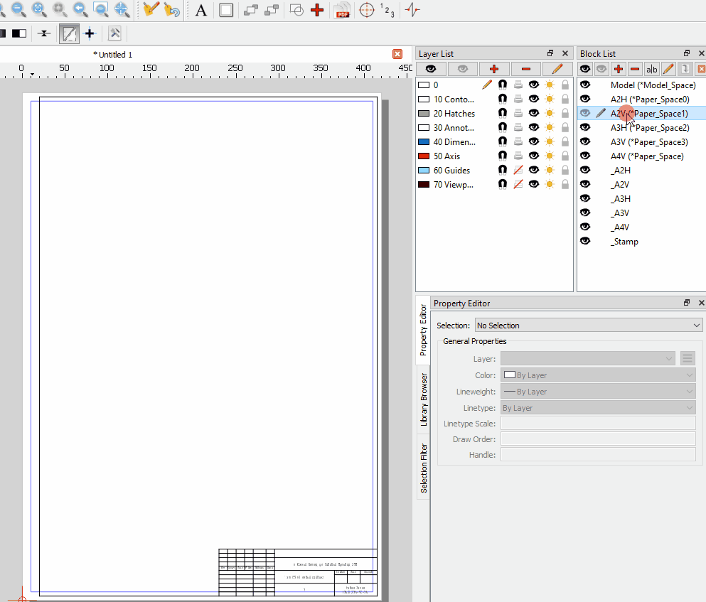

To duplicate the layout block, right-click on the desired layout block and select Duplicate Layout Block from the context menu

Post by dmitpon » Sat Jan 15, 2022 5:16 am
