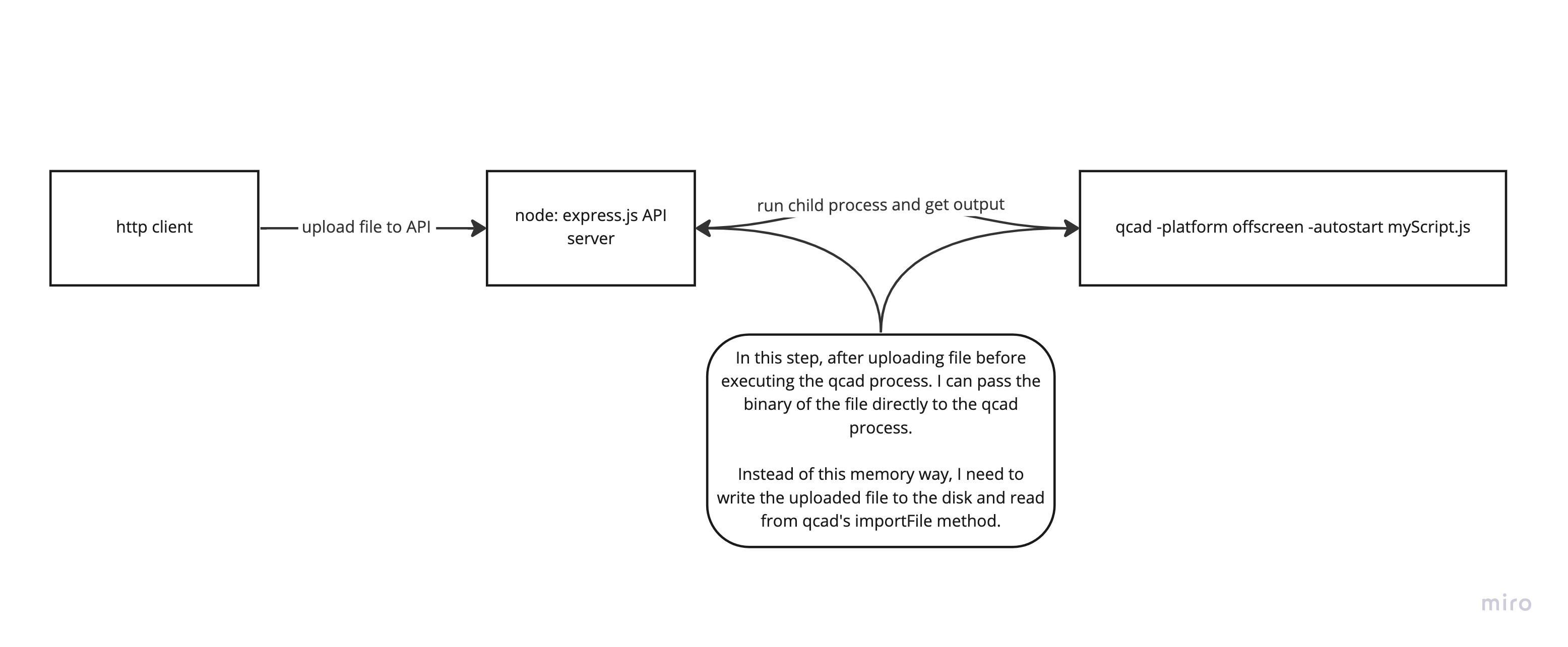

Let me give you an example. I'm trying to build an API service with node.js and child_process modules. When I upload the file to the server, there are two options: write the file to the temp directory or keep it on memory until I save it anywhere. The idea is to use that uploaded file buffer to the qcad process.
Here's the diagram:
Untitled - Frame 1.jpg (151.4 KiB) Viewed 10356 times
Posts: 4959
Re: Is it possible to import file from the buffer, or readed file data?
Post by CVH » Wed Nov 23, 2022 9:12 am
ilyasozkurt wrote:
Mon Nov 21, 2022 11:43 am
Honestly, Not a clue.
On open or on Import a file is read from disk to a new or to an existent document interface.
Unless there is a way to spoof the origin of the source I see no means.
