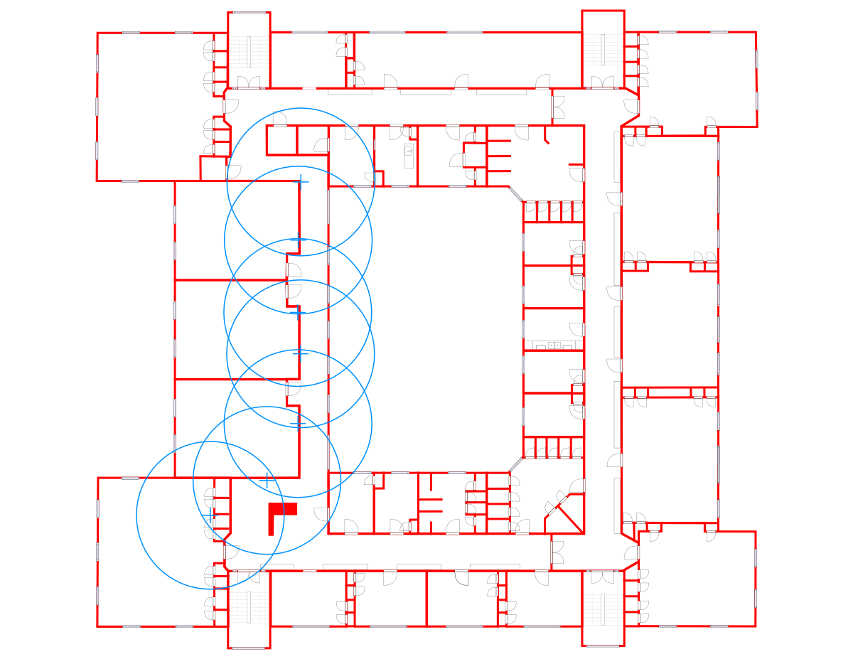

I'd like to use QCAD (Windows 10 version) to help lay out an installation plan for a network device using a building floorplan. The devices all need to be within 10m of at least one other device. Once all of the devices are placed I need to generate a CSV file with an ID and (x,y) coordinates for each of them.
From what I've read of the scripting engine, this seems straightforward. My initial thought was to create a new entity that is essentially a circle with a 10m radius and the ability to set a name/ID/label for the entity, and rely on a simple visual check by the user (it'll mostly be me) to ensure that each circle overlaps with at least one other. A more sophisticated approach would be to have the entity or the cursor change color when within the 10m range of a previously placed entity.
So something like the attached image, where the red lines are the floorplan and the blue lines are the new entity (labels not shown).
Then I'll need a menu option that dumps out a CSV that contains all of the entities with their label and the (x,y) of the circle's center point. In a perfect world there would also be a UI setting to change the 10m range to other values.

I'm delighted to say that the talented CVH did an excellent job of solving this problem for me.
You can see a screen capture of his rather nice solution here: https://youtu.be/A1d3s-DXW4g
- Posts: 4879
Re: [[SOLVED]] Looking for scripting help (paid)
All,
Basically 'Insert Block (BI)' with a major twist and a script to export the Block Reference positions and ID as CSV.
Of the BI method: Rotation, Scales, Flipping and Single or Array of Blocks were not required.
The Block is a cross-hair, a circle and 2 Attribute Definitions: TYPE and ID.
The Attributes are shown side by side in a custom Option Toolbar instead of in a drop-down box with default values.
TYPE and ID are by sequence: Gateway=2; Node=5; Node=6; Node=7; ... and so on, where ID is in hexadecimal notation (2, 5...fff).
The tool creates the Block and the required layers on a virgin drawing with for instance a floor plan.
Or it continues using the available structure on a drawing with existing items.
In that case it also looks up what already exists and continues counting from there.
The attributes of the next item to be inserted are automatically proposed according the required sequencing.
An existing sequence with gaps can be completed or one can add the next one up.
The tool can show none or 1...9 rubber bands to existing items that are the closest to the cursor position with distance labels.
The look of the circle representing the working radius can be changed on the fly as: Normal, Faded or None.
Several test and warnings were implemented.
Block, Block entities, Layers and so on may be manipulated/changed/deleted with standard QCAD tools.
In all these cases the tool doesn't fly blind and reports what can't be handled.
