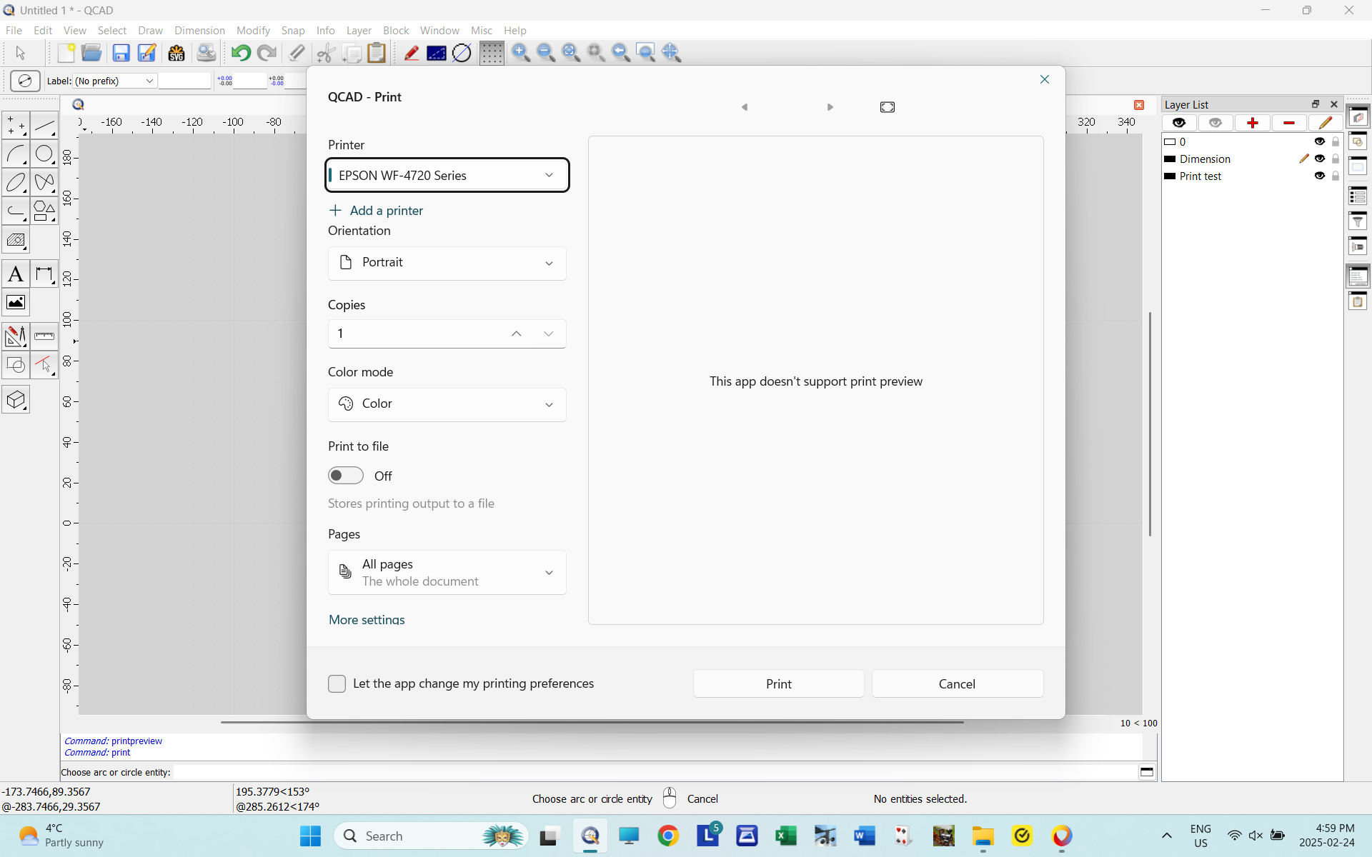

Ok, so I made a simple drawing of a circle , then did Print Preview (Ctrl+Shift+P) which worked as expected. Tried to Print (Ctrl+P) and got the same error again.

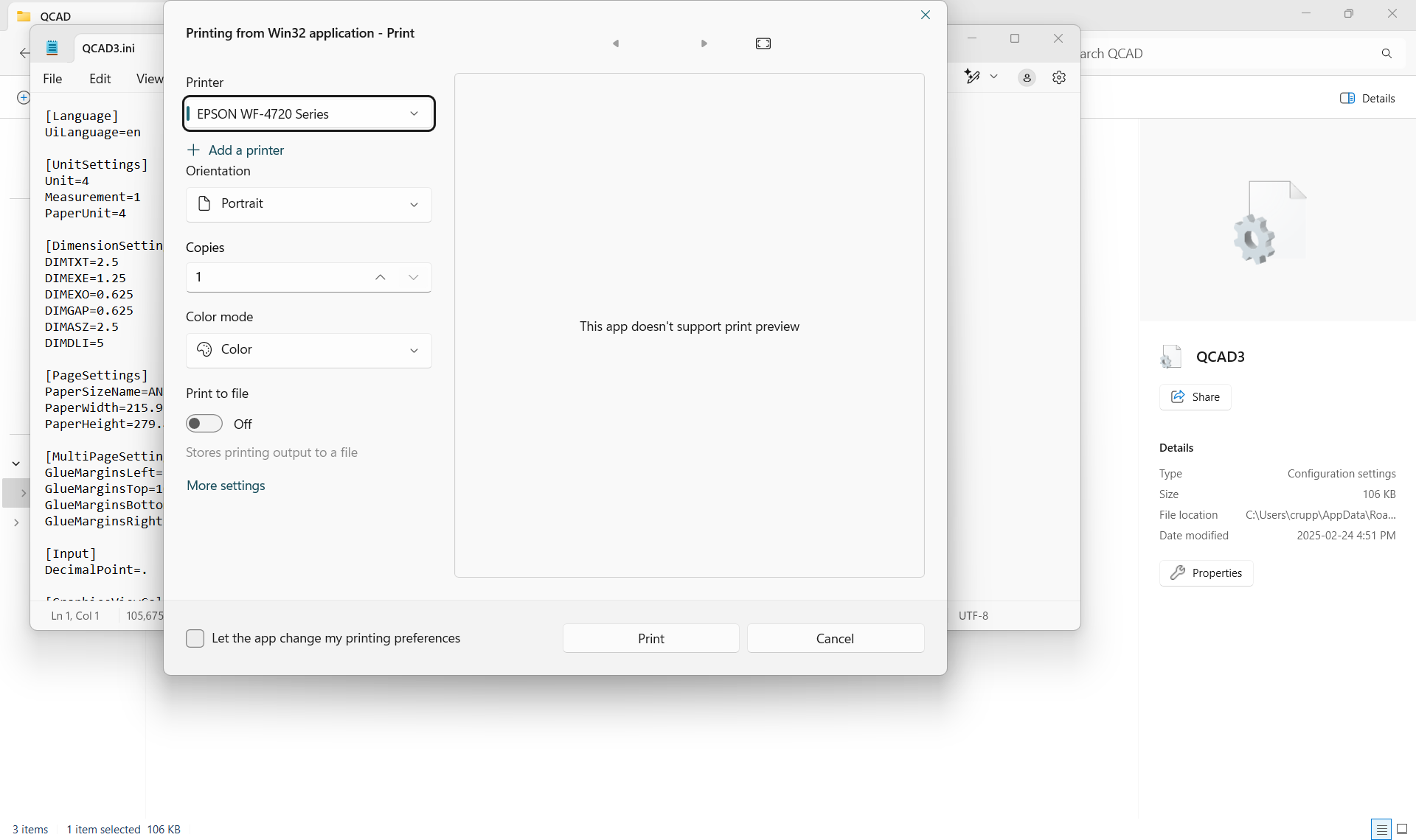

Out of curiosity tried to print QCAD3.ini and got the error again.
Installed QCAD3.ini from Windows10 and no luck.

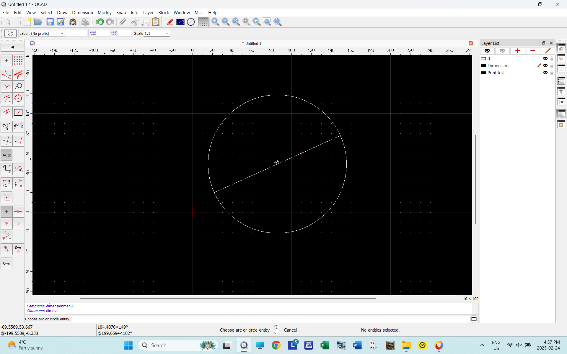

- Screenshot 2025-02-24 165953.png (271.76 KiB) Viewed 46883 times
- Screenshot 2025-02-24 165920.png (234.38 KiB) Viewed 46883 times
- Screenshot 2025-02-24 165746.png (227 KiB) Viewed 46883 times
- Screenshot 2025-02-24 165523.png (157.33 KiB) Viewed 46883 times

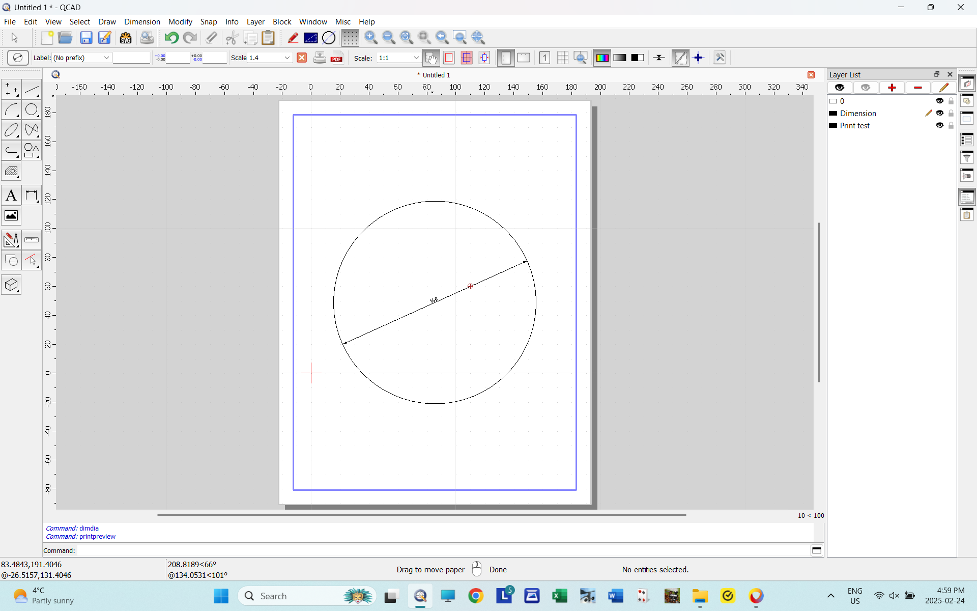

- Posts: 4995
Re: Unable to print Follow-up from Jan22
Question:
What happens when you select your printer and hit the 'Print' button?
That is all the functionality required from the printer Dialog.
To select a certain device.
QCAD does not start exporting geometry before that.
<Screenshot 2025-02-24 165920.png> is the best preview you could ever wish for.
It is called page preview mode.
